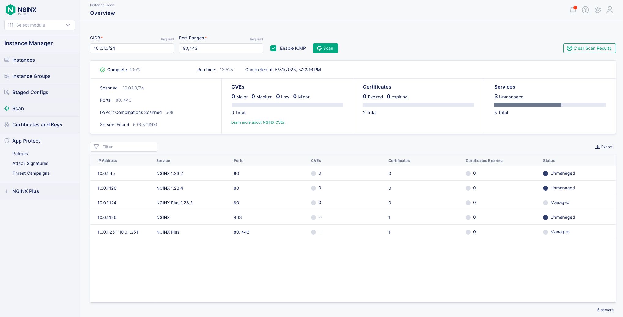

Instance Manager makes it easy to scan your environment for NGINX instances by identifying active hosts using the Internet Control Message Protocol (ICMP).
Two primary methods can be used to identify active hosts:
- Enabling ICMP
- Disabling ICMP
To scan for an instance, navigate to the scan page and provide the IP address along with the port number. This process is straightforward and can be accomplished by following the steps provided on the scan page.

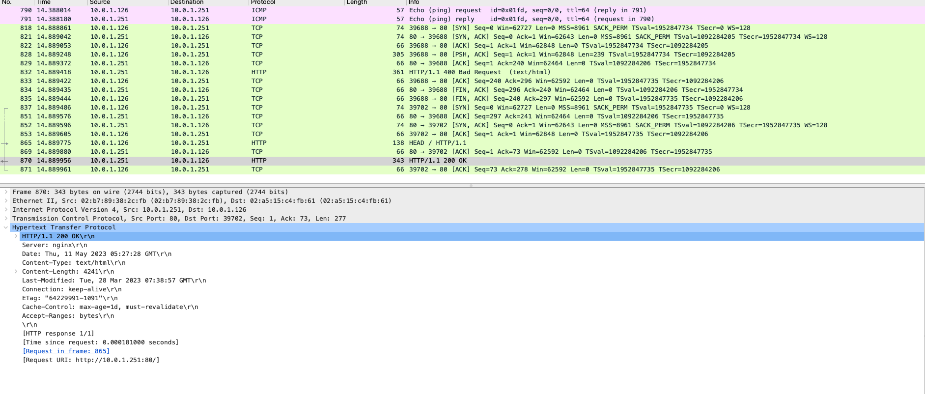

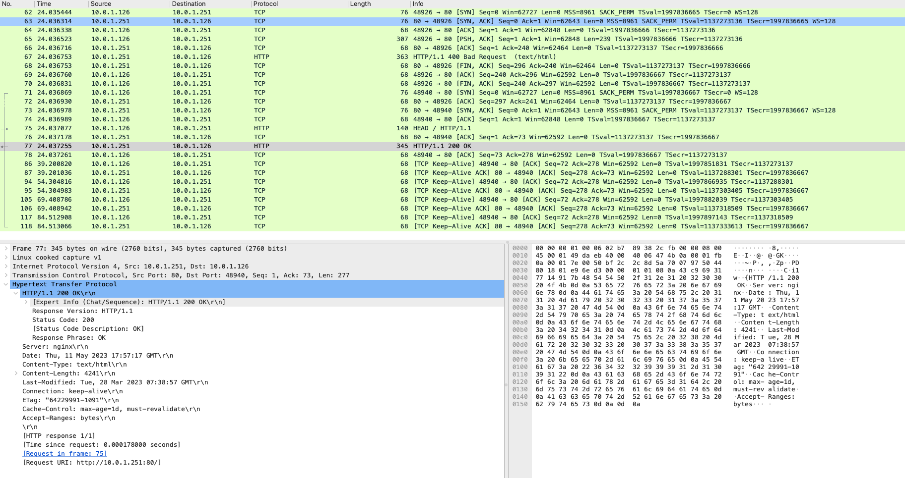

To identify active hosts, you first verify port accessibility using ICMP Hello packets and then perform a TCP handshake. To detect NGINX, analyze the HTTP header of the server.
Note: If HTTP is enabled in NGINX Plus, your scan may reveal any CVE vulnerabilities. However, disabling HTTP on NGINX Plus could potentially affect the accuracy of this approach. If you choose to disable it, your scan will not be able to identify any CVEs. Therefore, it is recommended to keep HTTP enabled on NGINX Plus to achieve the most comprehensive and effective results in identifying active hosts.
When ICMP is disabled, you can ensure the proper functioning of a port by verifying it through the TCP handshake method. This method assesses the port’s response and confirms that the port is working as expected. If the SYN request is answered, Instance Manager can determine if the port is running NGINX or if the certificate has expired.
Note: If the SYN request goes unanswered, the process may be delayed and can potentially cause port exhaustion issues.
Instance Manager has the capability to check the SSL certificate date of any server, whether or not it is part of NGINX servers. The module conducts a comprehensive evaluation of each server’s SSL certificate date to identify any potential expirations. Scans done by Instance Manager cover all requested ports, alert you of any expired SSL certificates, and provide valuable insights to help keep your enterprise safe.
Lastly, implementing role-based access control (RBAC) affords you complete control over who can initiate a scan and who has granted access to your scan results. With this feature, your sensitive information remains confidential and secure, as only authorized personnel can access the results.
