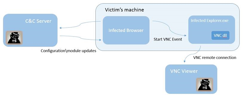

It connects to the infected user’s machine during banking transactions with a remote session. This session is invisible to the user because it is held in another instance of the desktop that the malware opens using the Virtual Network Computing (VNC) protocol. This instance is duplicated but not shared, meaning the attacker can’t see the user’s mouse and keyboard movement and vice versa.
After the malware is installed on a victim’s machine, it “phones home” to the Command and Control (C&C) of the botnet in order to get the target list and ask for the following modules: VNC and SOCKS.

VNC Activation Flow
The flow involves interaction between the infected browser and the infected explorer.exe process.

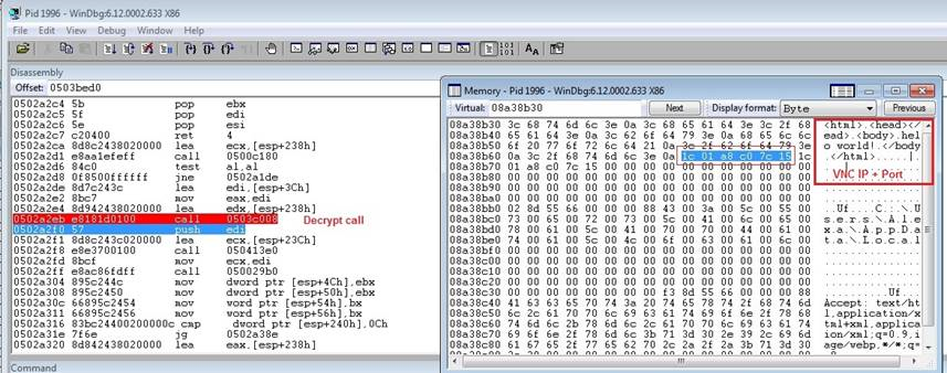

If the VNC flag is on, the malware expects to receive encrypted data. This encrypted data contains information that the malware uses later on:
- VNC IP and PORT — the remote address to connect to when launching the VNC session
- SOCKS IP and PORT — the remote address to connect to when launching the SOCKS session

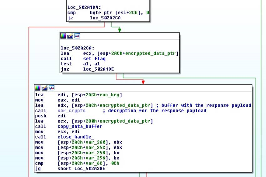

- The data is encrypted using a XOR (the first 4 bytes are the key)
Figure 1: Full decryption routine
Below is an example of a simple html response from the server with IP + Port appended (after decrypted routine):
Figure 2: Decrypted script content; the IP and the PORT are appended

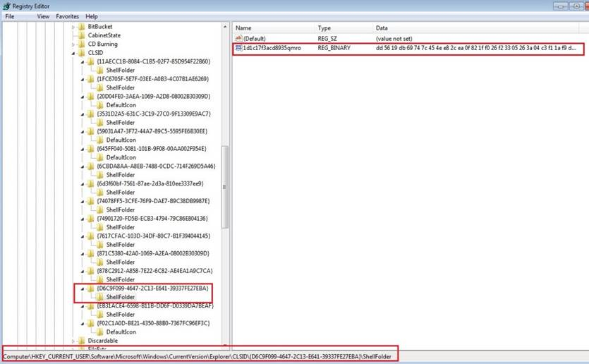

3. The infected browser stores these encrypted IP records in the registry under the same key as the configuration but under a separate subkey.
Figure 3: The IP and PORT registry records

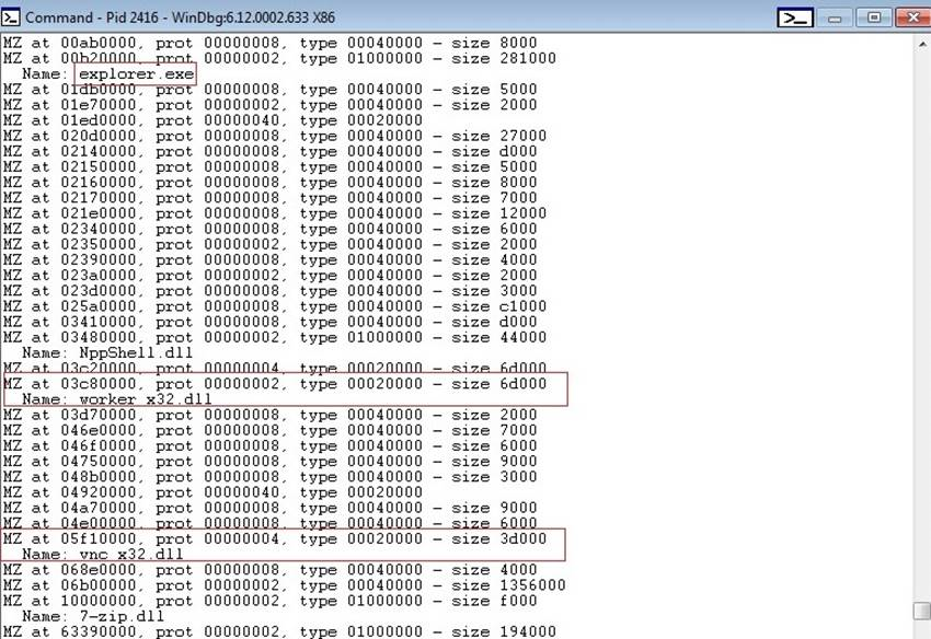

2. Explorer loads the vnc_x32.dll using a custom implementation of the Windows API “LoadLibrary”.
- Before this point, the VNC module resides in Explorer’s memory as raw data.
- After mapping all the PE sections, it calls DllEntryPoint of the vnc.dll (with DLL_PROCESS_ATTACH flag)
- This technique obfuscates the point in time where the VNC module is loaded, since it is not possible to follow “LoadLibrary”, making it much harder to analyze.
Figure 5: explorer.exe – the original explorer code, worker_x32.dll – the main Dridex module, vnc_x32.dll – the vnc module

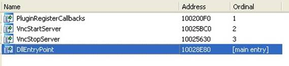

3. vnc_x32.dll exports two functions to start and stop the server.
Figure 6: VNC exported functions

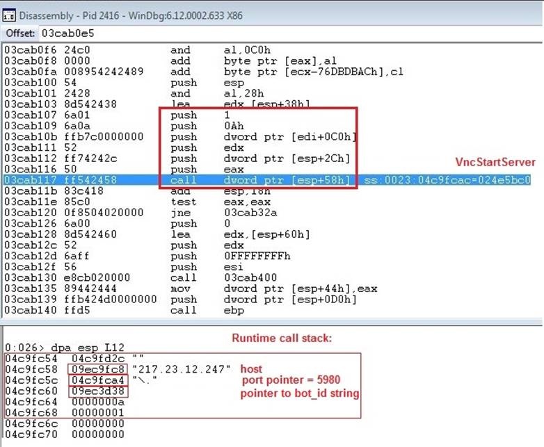

4. Explorer’s worker module calls the VncStartServer function with IP and port as parameters in order to launch the VNC connection.
Figure 7: The call to VNCStartServer with parameters

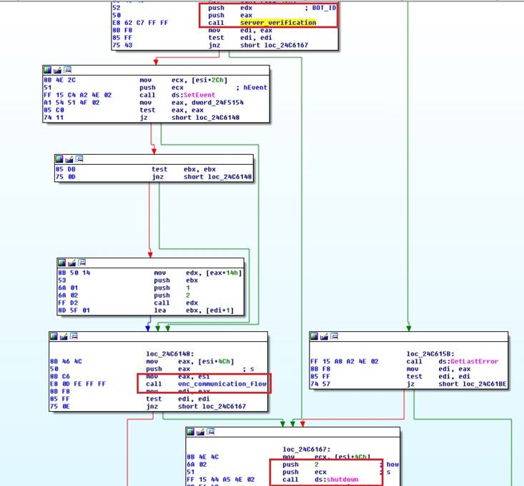

- After establishing a TCP connection to the VNC server, vnc_x32.dll uses the bot_id string – passed as a parameter to VncStartServer routine, in order to generate a challenge. This is used in order to verify the server’s identity before the VNC protocol handshake takes place.
Figure 8: Victim and attacker communications scheme
Figure 9: Verifying the server’s identity and shutting down in case it was not verified
