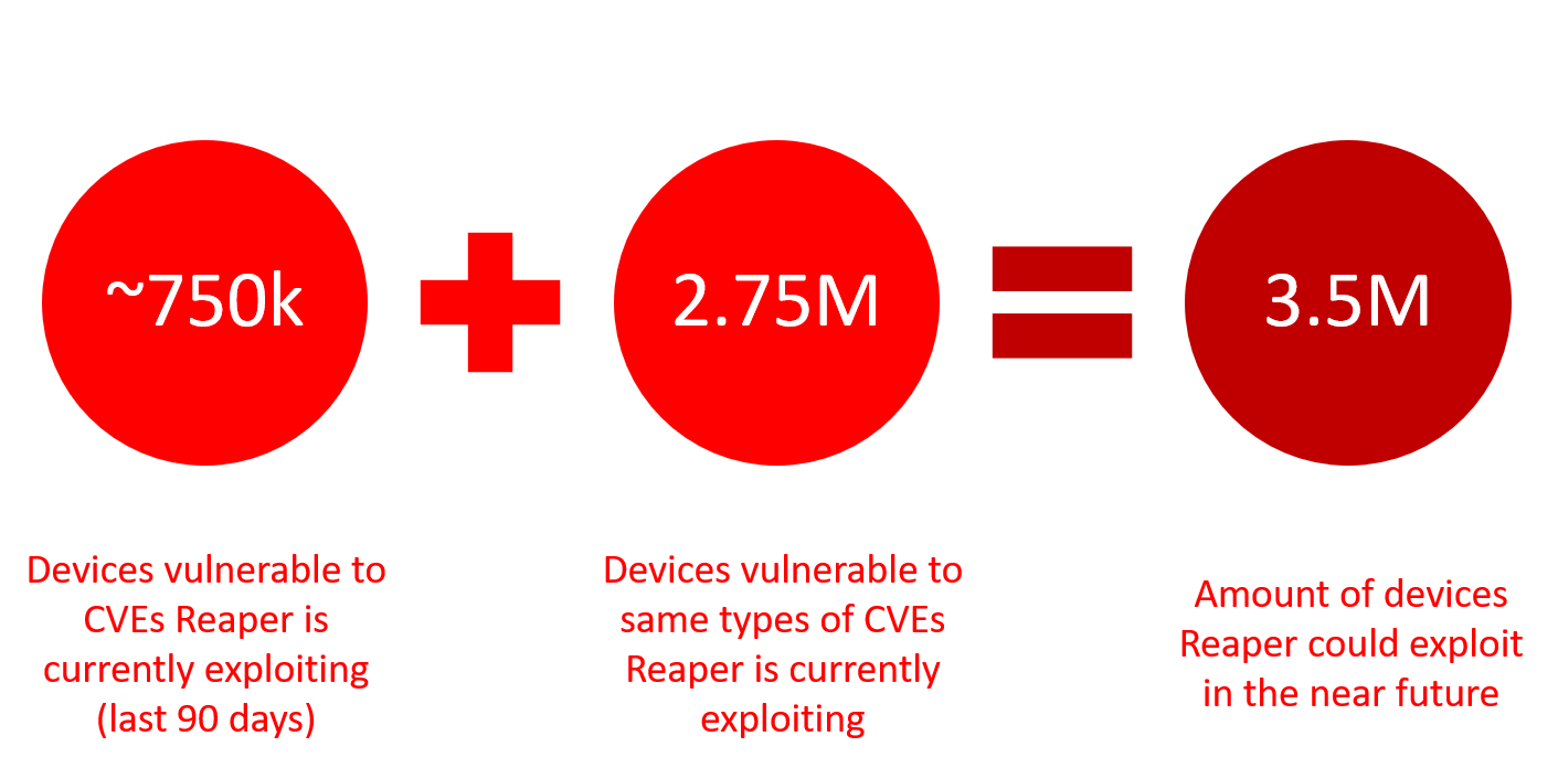

Krebs puts the current size of Reaper at over one million IoT devices. We have data that suggests it could include over 3.5 million devices and could be capable of growing by nearly 85,000 devices per day. The reason Reaper has gotten so big and, honestly, the reason we’re so impressed with its construction is that, unlike its predecessors, Mirai and Persirai, Reaper uses multiple attack vectors. Mirai used default passwords. Persirai used the blank username + password combo, which frankly is such a doofus security error on the part of the manufacturer that we feel it barely deserves to have a CVE.

Reports on the “size” of Reaper vary. We’ve scanned 750,000 unique devices that match the nine vulnerabilities currently exploited by Reaper. We regularly scan 85,000 new, “Reaper-compatible” devices per day. We don’t know which of them are actually infected, but there’s no reason that Reaper itself couldn’t infect them, unless its authors didn’t want it to.
The nine vulnerabilities currently used by Reaper are fairly rudimentary, as vulnerabilities go. If the thingbot authors were to include a few dozen existing vulnerabilities that fit Reaper’s device-targeting profile, we think they could grow the thingbot by an additional 2.75 million nodes. If they wanted to. Adding that 2.75 million to the 750,000 that are currently “Reaper-compatible” gives the number 3.5 million.
Note: We will not be disclosing the additional CVEs as that would simply expedite the authors’ exploits.
The actual size of Reaper is probably limited to whatever size its authors want it to be.
