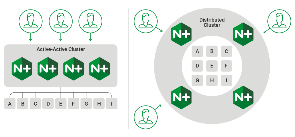

Classic load‑balancing methods such as Least Connections work very well when you operate a single active load balancer which maintains a complete view of the state of the load‑balanced nodes. The “power of two choices” approach is not as effective on a single load balancer, but it deftly avoids the bad‑case “herd behavior” that can occur when you scale out to a number of independent load balancers.
This scenario is not just observed when you scale out in high‑performance environments; it’s also observed in containerized environments where multiple proxies each load balance traffic to the same set of service instances.
Cluster topologies using distributed load balancers
A common instance of this scenario occurs when you use NGINX Ingress Controller for Kubernetes, with one load‑balancing instance per Kubernetes node.
