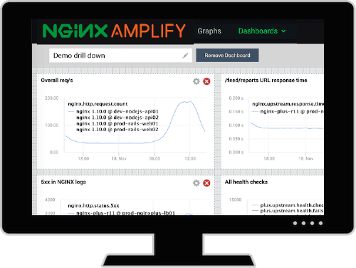

Monitoring NGINX with Amplify
We have a native tool for NGINX monitoring. It’s called NGINX Amplify, and it’s a SaaS tool that you can use to monitor up to five servers for free (subscriptions are available for larger numbers of servers).
It’s easy to get started with NGINX Amplify. You can get out-of-the-box graphs for all key NGINX metrics in under ten minutes. NGINX Amplify automatically uses metrics from stub_status and from access logs, and can collect various OS information as well.
Using NGINX Amplify, you can visualize your NGINX performance, and monitor the OS, PHP‑FPM, Docker containers, and more. A unique feature in Amplify is a static analyzer for your NGINX configuration that provides recommendations for making the configuration more secure and efficient.
Read more about NGINX Amplify here, and try it out for free.
Amplify screen for monitoring NGINX
NGINX Amplify is a key monitoring tool
