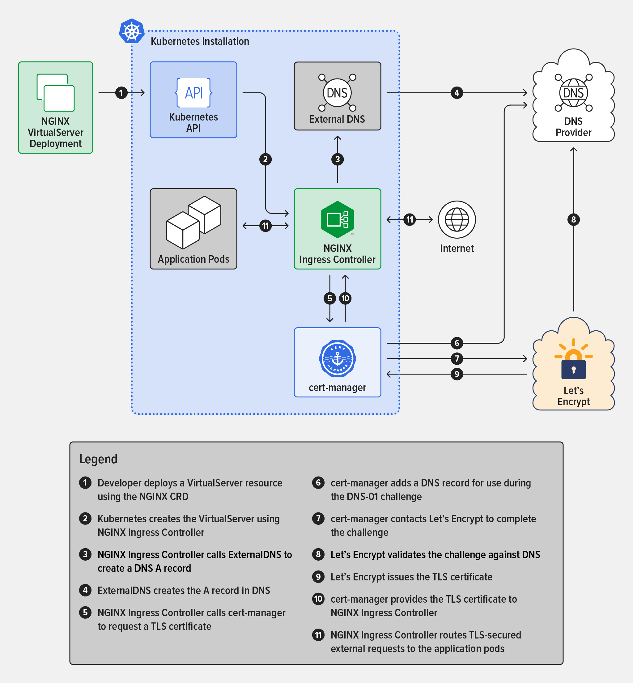

The ultimate goal of application development is, of course, to expose apps on the Internet. For a developer, Kubernetes simplifies this process to a degree by providing the Ingress controller as the mechanism for routing requests to the application. But not everything is as self‑service as you probably would like: you still need a record in the Domain Name System (DNS) to map the domain name for the app to the Ingress controller’s IP address and a TLS certificate to secure connections using HTTPS. In most organizations, you don’t own DNS or TLS yourself and so have to coordinate with the operational group (or groups!) that do.
Things aren’t necessarily any easier for operators. In most organizations the need to update DNS records is rare enough that procedures – both business rules and the actual technical steps – tend to be sparse or non‑existent. This means that when you need to add a DNS record you first need to find the documentation, ask a colleague, or (in a worst case) figure it out. You also need to ensure you’re in compliance with any corporate security rules and make sure that the ingress is tagged properly for the firewalls.
Fortunately, there is a way to make life easier for both developers and operators. In this post, we show how operators can configure a Kubernetes deployment to enable self‑service for developers to update DNS records and generate TLS certificates in a Kubernetes environment. By building out the infrastructure ahead of time, you can assure that all necessary business and technical requirements are being satisfied.
Overview and Prerequisites
With the solution in place, all a developer needs to do to expose an application to the Internet is create an Ingress controller following a supplied template that includes a fully qualified domain name (FQDN) within a domain managed by the Kubernetes installation. Kubernetes uses the template to allocate an IP address for the Ingress controller, create the DNS A record to map the FQDN to the IP address, and generate TLS certificates for the FQDN and add them to the Ingress controller. Cleanup is just as easy: when the Ingress is removed, the DNS records are cleaned up.
The solution leverages the following technologies (we provide installation and configuration instructions below):

What Happens When a Developer Deploys NGINX Ingress Controller
A lot happens under the covers once the solution is in place. The diagram shows what happens when a developer deploys the NGINX Ingress Controller with an NGINX VirtualServer custom resource. Note that some operational details are omitted.
  1. Developer deploys a VirtualServer resource using the NGINX CRD
  2. Kubernetes creates the VirtualServer using NGINX Ingress Controller
  3. NGINX Ingress Controller calls ExternalDNS to create a DNS A record
  4. ExternalDNS creates the A record in DNS
  5. NGINX Ingress Controller calls cert-manager to request a TLS certificate
  6. cert-manager adds a DNS record for use during the DNS-01 challenge
  7. cert-manager contacts Let’s Encrypt to complete the challenge
  8. Let’s Encrypt validates the challenge against DNS
  9. Let’s Encrypt issues the TLS certificate
  10. cert-manager provides the TLS certificate to NGINX Ingress Controller
  11. NGINX Ingress Controller routes TLS‑secured external requests to the application pods
