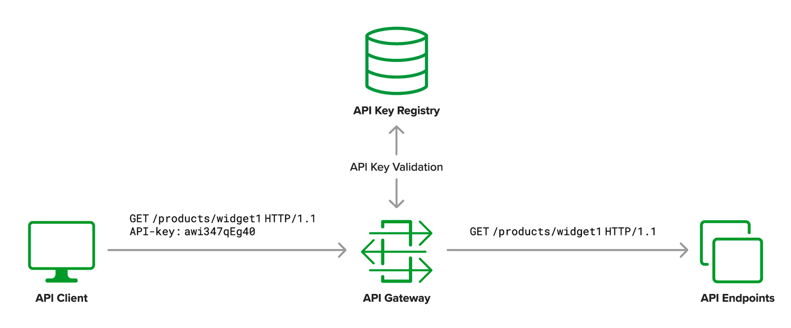

A common way to authenticate an API client (the remote software client requesting API resources) is through a shared secret, generally referred to as an API key. A traditional API key is essentially a long and complex password that the client sends as an additional HTTP header on each and every request. The API endpoint grants access to the requested resource if the supplied API key is in the list of valid keys. Generally, the API endpoint does not validate API keys itself; instead an API gateway handles the authentication process and routes each request to the appropriate endpoint. Besides computational offloading, this provides the benefits that come with a reverse proxy, such as high availability and load balancing to a number of API endpoints.
It is common to apply different access controls and policies to different API clients. With traditional API keys, this requires a lookup to match the API key with a set of attributes. Performing this lookup on each and every request has an understandable impact on the overall latency of the system. With JWT, these attributes are embedded, negating the need for a separate lookup.

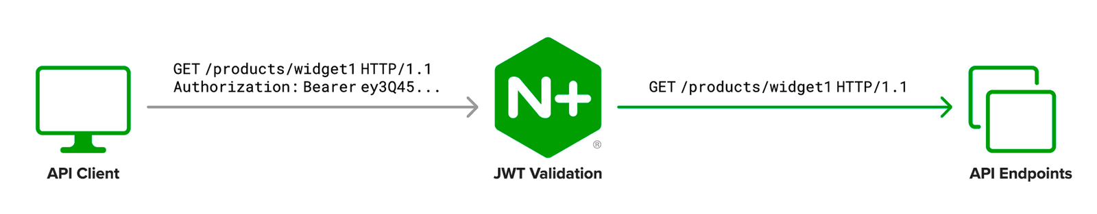

Using JWT as the API key provides a high‑performance alternative to traditional API keys, combining best‑practice authentication technology with a standards‑based schema for exchanging identity attributes.
The NGINX Plus configuration for validating JWTs is very simple.
